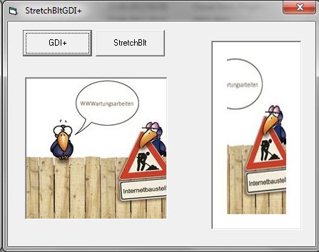

StretchBlt() mit GDIplus
Hier mal ein GDI+ Script als Ersatz für die StretchBlt-Funktion.
Quell-Code Form1
'Erstellen Sie folgende Steuerelemente:
'CommandButton Command1, CommandButton Command2, Form Form1,
'PictureBox Picture1, PictureBox Picture2

Private Sub Command1_Click() Dim token As Long 'GDI+ Picture2.Picture = LoadPicture("") Picture1.AutoRedraw = True Picture2.AutoRedraw = True ' Initialise GDI+ token = InitGDIPlus Picture2.Picture = StretchBltGDI(20, 20, Picture2.ScaleWidth - 40, Picture2.ScaleHeight - 40, Picture1.Picture.Handle, _ Picture1.Picture.Type, 100, 0, Picture1.ScaleWidth, Picture1.ScaleHeight, vbWhite) ' Free GDI+ FreeGDIPlus token Picture1.AutoRedraw = False Picture2.Refresh Picture2.AutoRedraw = False End Sub
Private Sub Command2_Click() Picture2.Picture = LoadPicture("") Picture1.AutoRedraw = True Picture2.AutoRedraw = True StretchBlt Picture2.hDC, 20, 20, Picture2.ScaleWidth + 47, Picture2.ScaleHeight - 40, Picture1.hDC, 100, 0, _ Picture1.ScaleWidth, Picture1.ScaleHeight, vbSrcCopy Picture1.AutoRedraw = False Picture2.Refresh Picture2.AutoRedraw = False End Sub
Private Sub Form_Load() Form1.ScaleMode = 3 Command1.Caption = "GDI+" Command2.Caption = "StretchBlt" Picture1.ScaleMode = 3 Picture2.ScaleMode = 3 Picture1.Width = 200 Picture1.Height = 200 Picture2.Width = 127 Picture2.Height = 265 Picture2.BackColor = vbWhite Picture1.Picture = LoadPicture(App.Path & "\Test.jpg") '-- 200 x 200 Pixel End Sub
